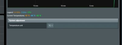

RT-AC66U B1(merlin 386.3_2)temperature values.
With 2 small fans at both ends. One blows and the other pulls. The room temperature is 27 degrees
