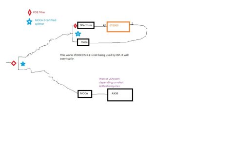

Here is a layout that will work. It isolates the DOCCIS 3.1 signals from your internal coax and allows you to upgrade as needed.
The router shown next to the Spectrum modem can be wired or wireless and spec'd to match bandwidth of your ISP connection. If you are planning to run AiMesh, then it should be ASUS.
You can use your existing GT6000 for now. If you need better wireless upstairs, then consider either 1) adding an AX58 upstairs and turning off wireless on GT6000, or 2) keeping the GT6000 upstairs and adding a wired ASUS router next to the Spectrum modem. Otherwise, you could use a wireless router next to the modem and put the two ASUS units in AP mode.
Once you get the DOCCIS 3.1 signals off your internal coax, you can use moca however you want. But that means putting the spectrum modem and a router where the ISP cable terminates.

All shuttered up and I was finally able to get to this. Put filter @ demarc before first splitter and was getting 5% of rated speed. Put additional filter on modem and am getting full speed.
However, I'm not noticing any improvement to node (with MoCA adapter) client's connection WiFi Tx/Rx or bars. I even set dedicated Ethernet Backhaul (1G). The system even moved one of the fixed clients (WiFi TV) to the main router that had been linked to node (and it had 3 bars and good Tx/Rx rate there before). AiMesh said better connection to main router (1 bar?). Not sure that it's really useful/worth it as that was the goal, to free up WiFi for clients connected to node. I was expecting better Tx/Rx rates and bars for clients connected to node with MoCA adapter especially with dedicated Ethernet Backhaul. Am I missing something?
I removed dedicated Ethernet Backhaul and put node on "auto". It defaulted to Ethernet 1G Backhaul on it's own. But I still don't see any difference in device/client connection (bars) or Tx/Rx from when Backhaul was 5GHz to MoCA adapter/Ethernet Backhaul (1G).
