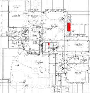

I dont have a true central place (middle of the main floor) -- that is the stairs. I can put it under the stairs in the basement or 3/4 to one side on the main floor
Diagrams show main level... large red area is on the main floor... the small red area is under the stairs, in the basement. I have wires in both places. I have a router in the large area currently, and on the top floor above the stairs (mostly center of the house)

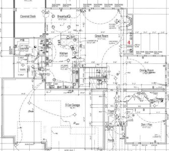

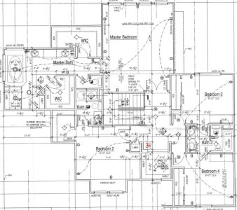

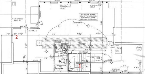

@L&LD where would you place the GT-AX6000 & RT-AX68U in my house? I've attached blueprints with #s at the locations I have wires to the cable modem (in basement under the stairs)
for instance... AX6000 at #1 in the basement (under stair well - center of the main floor which is above it) + AX68U at #3 on the top floor (above the stairs - center of floor)... would that give good coverage?
