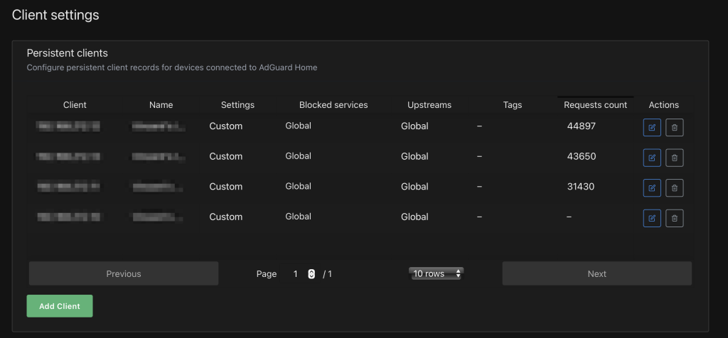

Thanks, @Makaveli. I can see AdGuard can block YouTube to all network, It's possible to block in specific device using IP or mac address?
You can setup custom filtering per client
Click on edit for that client and then block the services that you are interested in.
You can also set specific DNS servers per client so that if you wanted a highly restrictive DNS server for that client, you can leverage that for the kids. Adguard does a decent job at blocking most inappropriate content if you have the filters setup correctly. Highly recommend.
@elrengo do this!!
I just tested this by blocking youtube on my cell phone.
