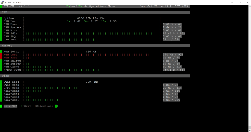

Copied rtrmon.sh script to my AiMesh node, and tried to run it. It'd configure, but would not run since it's complaining about missing dependencies.
What's the simplest way to blank out those dependencies? Are there 1-2 places in the script for easy blanking? Alternatively, I'll dig through this a bit later!

RTRMON Lite doesn't exist. RTRMON requires entware packages, period. I'm not sure why the reluctance to add storage, given that it would most likely only be active when RTRMON was actually being used.

I grep'ed, and I grep'ed, and so on ...
(well, not really !) :)
Anyway, 1 line change does it (line 4761 for version 2.1.3), so great software engineering there given how easy it is to tweak it!!! Whoever wrote this - thank you!!!
#      if [ -f $CFGPATH ] && [ -f "/opt/bin/timeout" ] && [ -f "/opt/sbin/screen" ] && [ -f "/opt/bin/nmap" ] && [ -f "/opt/bin/jq" ] && [ -f "/o
      if true; then
Update: I could page through all screeens with N, I'd say about 70% of stuff works. The script is graceful wrt missing stuff!

Unfortunately, randomly commenting out one line of code does not fix your issue! You may have gotten past that point, but there will be other issues...

It's a good proof of concept! Many features do work just fine!
It might be that someone is dying out there for such functionality - in that case more work would be warranted. If no interest, can remain a curiosity ...

I think the basics will probably still work, but you may run into errors viewing other pages other than 1-3... would be an interesting experiment.

Almost guaranteed. ;) Maybe a better alternative would be to try to detect if it's running on an iMesh node, and hobble some of its functionality.

Why bother? Install it properly, and enable option (12) : Mark Router As (A)iMesh Node/Repeater/Bridge.
BAHAHA... OMG, I totally forgot about that feature. Now if I can only remember what the heck it turns off. ;) Oh yeah... it was dealing with errors you would normally get from WAN0, which wouldn't be present on an iMesh node. ;)
Yes, I just installed it on an RT-AX86U AiMesh node — once again, just because I could! There are a couple of screens that "don't work" (and rightly so), but there are no crashes.
