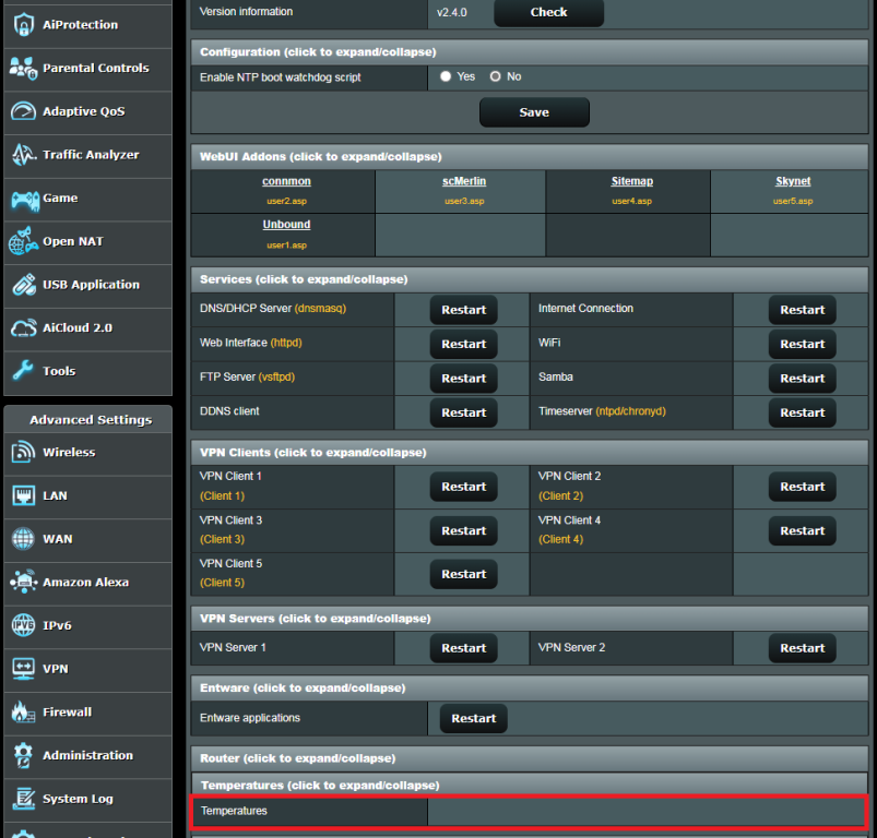

I have noticed the following discrepancy with my new GT-AX6000 (displaying fine with my old RT-AC86U):
Confirming same issue with my RT-AX86U, displaying fine in scMerlin cli, but just blank in web page.

Hi Stephen, we have both the same reported issues...
I found a stupid solution to the blank temperature display🥹🥹
search ”update_temperatures“ in "/jffs/addons/scmerlin.d/scmerlin_www.asp",Then open the website according to "url: '/ajax_coretmp.asp' ".(e.g. http://192.168.1.1/ajax_coretmp.asp)
Compare the temperature on the page with the "amtm ==> scMerlin ==> t ",distinguish function meaning.(for me:curr_coreTmp_wl0_raw ==> 2.4 GHz,curr_coreTmp_wl1_raw ==> 5 GHz)
Modify the content under ”function update_temperatures(){“
(for me:curr_coreTmp_2_raw ==> curr_coreTmp_wl0_raw,<b>5 GHz:</b> <span>' + curr_coreTmp_5_raw ==> <b>5 GHz:</b> <span>' + curr_coreTmp_wl1_raw )
Finally, remember to modify the content in the mapping file /www/user/user*.asp.
I suspect this error may be because different firmware versions modify the name of the temperature function, too many versions, different hardware, too much confusion.
