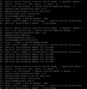

cat /sys/kernel/debug/usb/devices gives me the following:
T: Bus=02 Lev=01 Prnt=01 Port=00 Cnt=01 Dev#= 2 Spd=5000 MxCh= 0
D: Ver= 3.00 Cls=00(>ifc ) Sub=00 Prot=00 MxPS= 9 #Cfgs= 1
P: Vendor=152d ProdID=0578 Rev= 2.04
S: Manufacturer=JMicron
S: Product=External USB 3.0
S: SerialNumber=201703310007F
C:* #Ifs= 1 Cfg#= 1 Atr=80 MxPwr=896mA
I: If#= 0 Alt= 0 #EPs= 2 Cls=08(stor.) Sub=06 Prot=50 Driver=uas
E: Ad=81(I) Atr=02(Bulk) MxPS=1024 Ivl=0ms
E: Ad=02(O) Atr=02(Bulk) MxPS=1024 Ivl=0ms
I:* If#= 0 Alt= 1 #EPs= 4 Cls=08(stor.) Sub=06 Prot=62 Driver=uas
E: Ad=01(O) Atr=02(Bulk) MxPS=1024 Ivl=0ms
E: Ad=82(I) Atr=02(Bulk) MxPS=1024 Ivl=0ms
E: Ad=83(I) Atr=02(Bulk) MxPS=1024 Ivl=0ms
E: Ad=04(O) Atr=02(Bulk) MxPS=1024 Ivl=0ms

Result of cat /sys/kernel/debug/usb/devices when SandDisk USB stick is attached:
result of cat /sys/kernel/debug/usb/devices when SSD Samsung EVO is attached with enclosure:

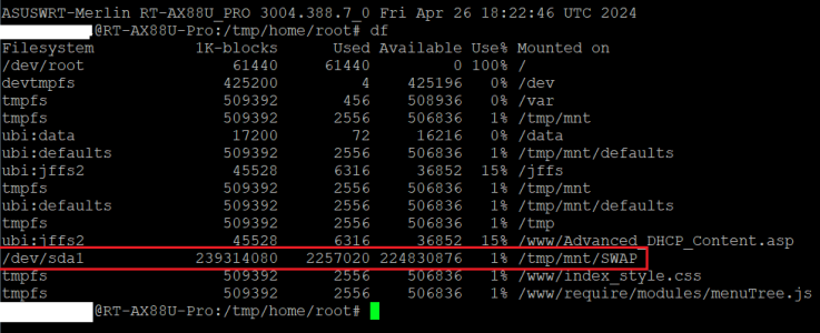

With both devices result of df is exactly the same:
Also: all scripts are running fine when I do the trick and unplug -> plug the cable in the router so it proves nothing is wrong with SSD disk and configuration.
The issue is with SSD disk not being detected and therefore mounted when router is rebooted.
