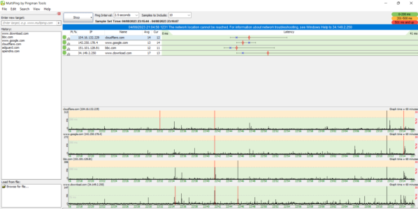

These are the latest ping results before I retire for the night. I'll post the overnight results in the morning.

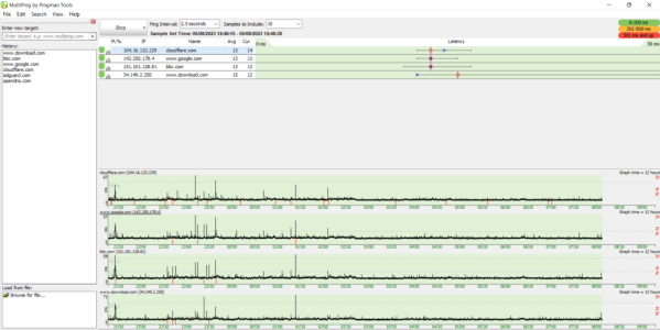

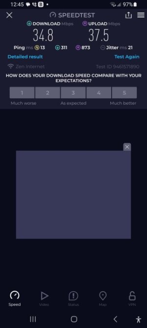

These are the overnight ping-test results. I've also just done a speed test and that's fine as well. The router is still on auto channel 8.
