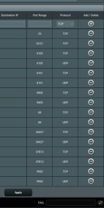

These are some ports I would block based on what I saw on the Android TV and Samsung phone was listening
Also 8853 I kept seeing

The is nothing unusual or suspicious in your netstat output or in your syslog files.
