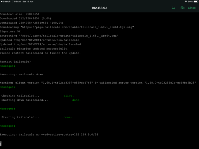

@XIII ... just wanted to let you know I attempted the upgrade from v1.66.4 to v1.68.0 on my test router, and went flawless... Again, I'm on v1.0.17b1...
No issues with the download, install, and service/connection restart:
Coming back to the main UI, showing that everything is humming along perfectly without needing any other intervention:

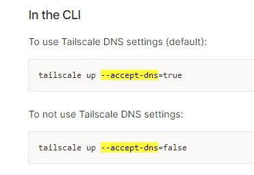

I explicitly set accept-dns to false to prevent conflicts with NextDNS:
However, I don't see it in my current custom values in TAILMON, so I'm going to add it there.
Ah yes, I recall now, you are in the situation where you can’t ignore the overwrite (as suggested earlier in this thread) and you have to use the accept-dns=false workaround for your use case.
# Health check:
# - Linux DNS config not ideal. /etc/resolv.conf overwritten. See https://tailscale.com/s/dns-fight

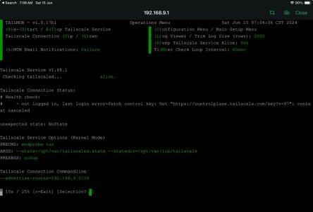

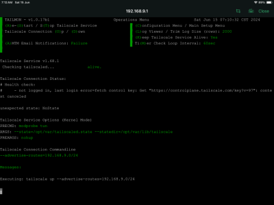

I just tried to update 1.68.0 to 1.68.1 and for the first update ever, it hung on the the tailscale up line.
Manually downgraded to 1.68.0; same
Manually downgraded to 1.66.4; same
Rebooted Router. Same.
Just my system, bad SSD or Tailscale might have broken something ?
# Health check:
#     - not logged in, last login error=fetch control key: Get "https://controlplane.tailscale.com/key?v=97": context canceled
# Health check:
#     - not in map poll
unexpected state: NoState
[EDIT] It seemed to have fixed itself, not sure how, but tailscale up lines seem to take a long time to "take".
