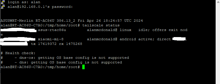

ive just instaled this script and in the Tailmon UI it shows as being up and running but on the tailscale official dashboard the device shows as offline.
Any ideas where I am gong wrong guys?
Thank you
Thank you
While Tailmon is running, from a separate SSH window, can you run "tailscale status", and please post those results?
Thank you for your reply, I just had to update the tailscale version and restart and it works great now.
Only issue is when I am connected to the tailscale instance on my router from my phone, the download speed is 1-2mbps
any idea what could be wrong there?
And here is a screenshot of the status
