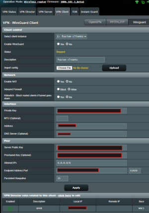

I'm trying to setup vpn for all network attached devices but without the need to configure it on the devices itselves.
The wireguard server is up&running and working because I have a VPN client for my mobile phones and they just work fine using local config on the mobile phone.
For the other devices I setup a new client in the same server using a different ip as the mobile client.
I created a wireguard client (see screenshot) . I linked 1 device to test all, but the device is unable to connect to the wifi or internet.
What is wrong in my config.
  • 2025-01-07 08_54_23-ASUS Wireless Router RT-BE88U - WireGuard Client and 3 more pages - Person...png

So you're running both a server and a client on the same router and trying to connect one to the other?

So... a LAN client's traffic goes to the router... it goes out the fusion client... comes back in to the router through the WireGuard server... then VPN Director sends the traffic out to the internet via a different VPN client instance.
I think my brain has exploded.
Why not just use VPN Director without this fusion-to-WireGuard loopback?

EDIT: Can you clarify something that I may have misunderstood? When you said "a wireguard server is up & running" I assumed you meant that you had turned on the WireGuard server on the VPN - VPN Server page. Is that what you meant? Or did you mean that you had turned on the VPN - WireGuard Client instance and was able to connect to it from your phone?

Wireguard VPN server is running and a configured VPN tunnel which I use for smartphone (gsms on the screenshot) (which have the wireguard client installed) is working .

Please don't blank out private ip addresses you use internally, they are of no use to anyone else. But it's really difficult to understand your setup when we can't see them.
For Wireguard you should foremost blank/remove the keys. If you want you could also remove Endpoint address and Dns if you want to mask what provider you are using.
Under the VPN->Status tab there should be a section for your started vpn. Could you post that, with blanked out keys? I'm interested in Rx/tx bytes count and latest handshake to see if the tunnel is working or not.

Wow, you are really connecting back to yourself as @ColinTaylor speculated. I thought surely this must be some misunderstanding, but appearantly not.
Where have you got the information that this was a good idea? (Or any idea?)
Regardless, this won't work. Your peers are indeed working but you create a routing conflict by doing this way. Neither would it add any value for you. If you describe what you want to achieve we may be able to point you to a different way to achieve what you want?

While vpn Fusion may dodge the routing conflict and make it work, the only achievement would be loss of bandwidth and increased latency, both wich are decremental for your internet experience. You wouldn't change your internet ip or location or increase connectability so nothing gained.
