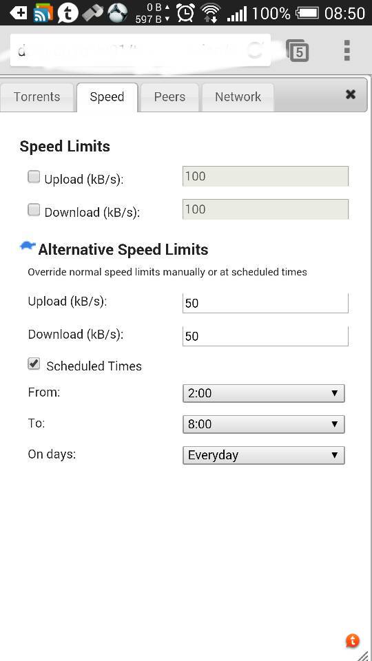

Does Transmission support scehduling? For example, if I want to schedule all downloads to run between 2am and 8am (during this time the downloads do not count towards my total allowed by my ISP) is it possible in the GUI?
