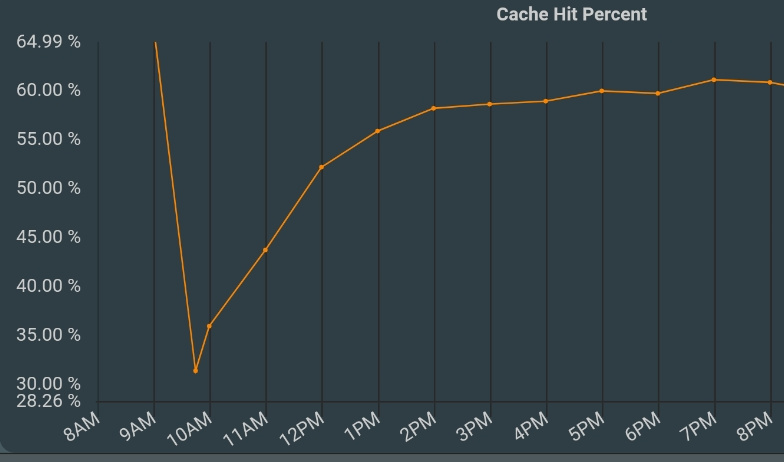

I have a question about saving the Unbound DNS cache. I did an upgrade from 384.16 to 384.17 beta1. The DNS cache was empty afterwards (see picture).
Before I do an update again I would like to know if there is a way I can backup and restore the cache?
Thanks!
Thanks!
Before performing a firmware upgrade, you should always perform the following mandatory manual tasks
  1. Backup /jffs/
  2. Backup NVRAM variables
  3. Cleanly unmount the USB attached disk(s)
If you're concerned about preserving your unbound cache then you will need to add an extra manual task (step 3) to save it. (I doubt the firmware update process honours/executes the 'services-stop' script)
i.e. in 'Advanced' mode see the option under the '3 Advanced Tools' menu
dumpcache = [bootrest] (or Manually use restorecache after REBOOT)
e  = Exit Script [?]
[Enter] Leave Advanced Tools Menu
e  = Exit Script [?]
A:Option ==> dumpcache
If you use the 'bootrest' option, the cache restore command will be permanently added to 'post-mount' and will write a message in Syslog during the boot sequence if it finds a cache file to auto-restore:
RT-AC68U post-mount[2303]:     unbound cache RESTORED from '/opt/share/unbound/configs/cache.txt'
NOTE: As stated many times, whilst preserving the unbound DNS cache seems to be in fashion (no one ever worried/expressed concern about losing/restoring dnsmasq's DNS cache :rolleyes:) there are dangers e.g. malacious cache poisoning, or unintended propogation of stale cache entries.
So if for example you have used 'dumpcache' to backup unbound's cache, suppose you have issues with the firmware upgrade that takes say an hour to resolve.
Do you really want to restore a cache that basically is well past its sell-by-date?o_O
