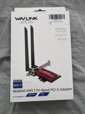

hello all
I purchased this wifi 7 adaptor for my AMD setup. It does work but problem is 2.4,5 & 6GHZ are all limited to 20MHZ in the settings . Would there be anything that I have done wrong or am I best just sending back.
I can connect to the 2.4ghz & 5ghz band but the 6ghz one connects but says no internet.
I’m trying to connect to ASUS GT-BE98 router

I’ve just looked and it’s out of stock. Also it’s a bit pricer than what I want to pay. Do you know any UK Sellers who may have any different ones.
Send it back and get the Qualcomm NCM865. It comes in a couple of flavors with or without the antenna backplate. MSI sells it with the backplate for $50.
I assume drivers are already in Windows Update?
DL from the either GB/MSI website to get it going then, maybe WU might have the update now. I blocked and disabled WU tone prevent it from messing up other stuff and just use patch Tuesday bulk single update instead.
Are you using Windows 11? If not, you won't be able to get it fully functional.
There's no WiFi 7 support in Windows 10.
