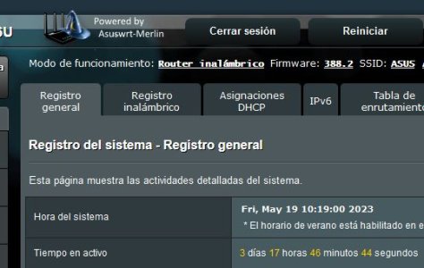

Following this thread, I thought that I could enable Flow caché on my AX-86U. I am running Asus Wrt Merlin 388.2 with Martineau's Wireguard Session Manager.
I did so, but registry log starts throwing a lot of kernel errors:
I think you need wgm latest dev version for this to work: uf dev. Also it only works for source rules, not destination rules.
Correct. After updating WG Session Manager, those awful kernel messages have disappeared.

Edit: Bad news. After getting a correct log all morning, now those strange kernel messages have started to appear againg. Is there any thing I can do?
Of course I updated session manager with the
'uf dev'
command.
