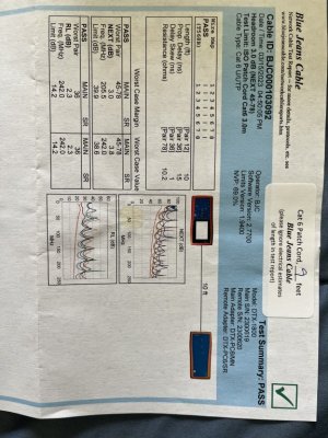

Test report from one of the cables I got recently is attached. Great quality wire (Belden) and connectors.
