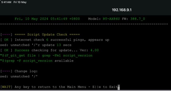

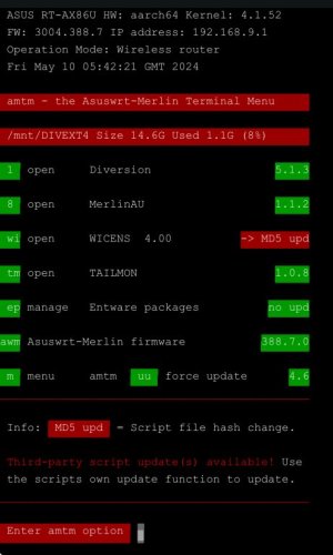

Hi, amtm recently showed this (see pics) which after I tried to update the script, still comes up when I press ‘u’ for update in amtm.
It’s just a checksum apparently, so it goes away eventually, just a FYI at this point?
You're too quick. I literally just pushed a couple minor updates (no version change) to the script update function, 1 was cosmetic, the other fixed issues with pulling the newer version numbers if there ever is another update (as seen in your second photo)
The MD5 update is amtm seeing the script has changed but without a version update

All good, thanks for the reply. Strangely you're missing some logging I would expect but its possible it ran prior to syslogd being started, or maybe you're using something like scribe and was in-between? without the full log I couldn't say for certain
You're missing wicens[11027]: cron : WAN IP has changed to... and wicens[11027]: cron : Attempting to send...
Im not sure what to make of this.. some of the timing looks weird and wancall shouldn't have seen a different IP running 14 secs after cron did
Is this router in Dual NAT (wan ip is private?)
If you want you can add F_uptime && [ "$router_uptime" -lt 300 ] && exit 0 to line 4161 prior to the NTP check for cron, this will prevent cron from running if the router hasn't been up for 5 mins
