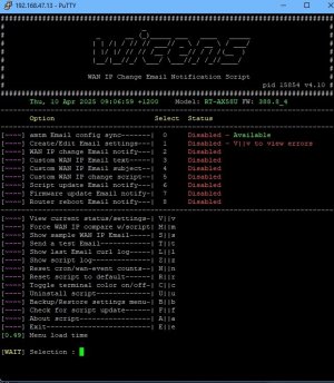

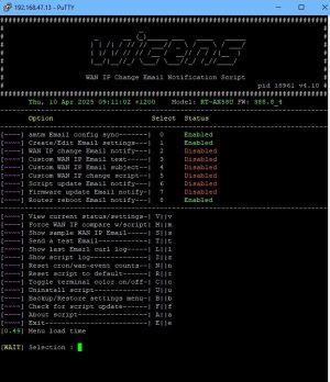

Hi
Just had occasion to put WICENS on a Mesh Node, specifically for a Reboot email (8) only, as obviously it doesn't have a WAN IP itself to perform aa WAN IP change (nor did I want that). I have email set up in amtm so I wanted to just sync (0) with that, not edit any settings (1).
When I pressed (0), enter, it started a a WAN IP check; then failed a couple of times (no WAN IP, as ex[ected) and then went back to the amtm menu.
When I went back in it shows Enabled and Enabled for (0) and (1) for the email (which is good), so I could choose (8).
So I got what I wanted in the end, was just a bit ugly getting there, perhaps as a suggestion, defer that WAN IP check until after a user selects that as an option?
Yes I noticed the same when implementing my Opnsense box as my gateway (AP mode has the same issue), this should be a matter of commenting out a few lines in the setup. Writing the WAN IP on settings creation is legacy from the V1 days (prior to the option to selectively enable WAN IP notifications). Ill take a look this weekend hopefully.

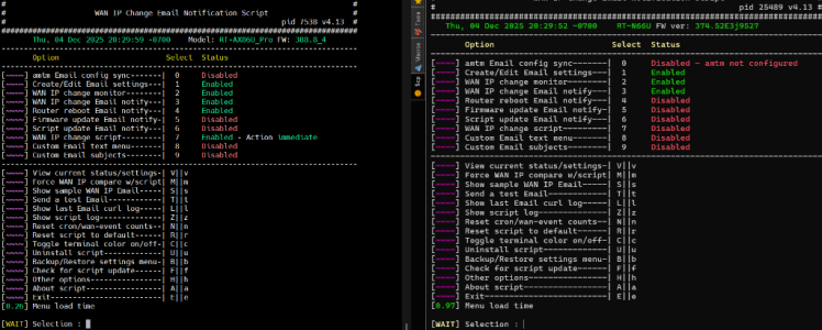

## 4.11
April 10 2025
* ADDED: cron fully customizable in wicens_update_conf.wic
* ADDED: cron on/off in wicens_update_conf.wic (cron_option 1=on 0=off) (off: cron entries will still be created, script will immediately exit on cron runs)
* NOTE: disabling or editing cron beyond 20 min (default:11min) intervals is not recommended
* ADDED: can disable jffs independent logging in wicens_update_conf.wic (script_log 1=on 0=off)
* ADDED: can change independent log location in wicens_update_conf.wic (script_log_loc)
* CHANGED: don't write WAN IP after Email settings creation
* CHANGED: check if hardware is in router mode for WAN IP notifications
* CHANGED: added menu option for hidden options/other minor appearance tweaks
* CHANGED: core config from v4.1 to v4.2 for cron/logging options
