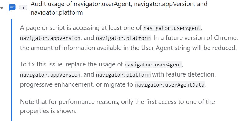

Never looked for console errors before so here goes:
Above from Google Chrome. The 'Quirks' error repeats as the Completed circle continues.

ok so the settings save, that's fine. but because there are then no enabled clients yazfi incorrectly exits. I'll fix that.
re. the page load, those messages can be ignored and are unrelated. can you do a video of what happens? it might be ax86u specific because I don't see it on ac68u or ac86u. the page reloads as expected
