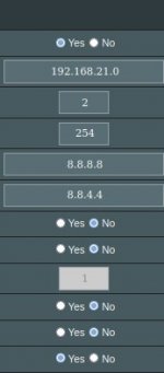

With YazFi on my RT-AC68U w/Merlin 386.3_2:
If I check "Client Isolation" for a guest network, that network then ceases to work correctly -- my Android phone tries to connect, then disconnects and tries again, over and over..
Why?
