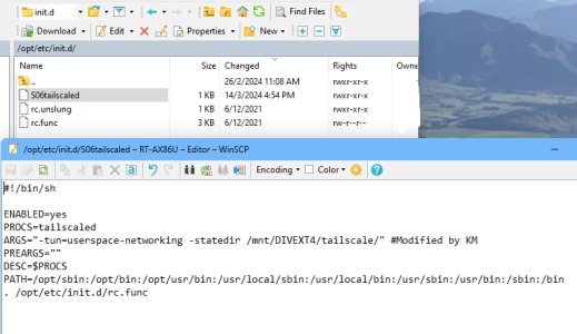

Maybe have a look at my S06Tailscaled file from the init.d directory and compare it to yours, see attached.
See also contents of various Dirs where the binaries go, just to satisfy yourself the paths are correct. My Disk is called DIVEXT4,

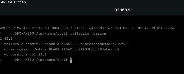

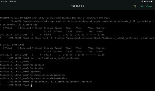

I’ve already updated to the latest 1.62.1 (I’ll make a post shortly about a CLI command to do that which seems to work). No problems with the new binaries.

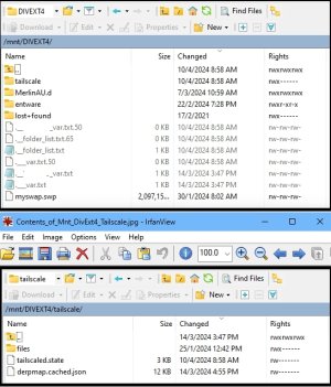

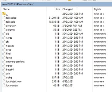

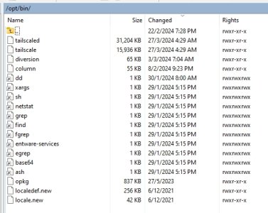

I also updated via entware, and noticed the same thing. A quick (re)edit of ./S06tailscaled fixed it for me too.
I have a GLiNET Router (Beryl AX MT-3000) and there's a few folk updating Tailscale on that device, so thought I’d modify the commands for the ASUS Merlin Tailscale install in this thread.
Manual Update:
# Using the advice shown here for that device (from GLiNet) I amended the path from /usr/sbin/ to /opt/bin as shown below, to match the original instructions given earlier in this thread for updating the ASUS Merlin tailscale install.
# You will need to change the Version Number, appropriate to the latest version (from Tailscale Static Binaries) for arm64 devices and just copy and paste into the Asus Router CLI (assuming you have Tailscale installed as detailed in this thread). I just search and replace the text for old ver to new ver e.g. search and replace 1.62.1 by 1.64.0.
cd /tmp; curl -f -L https://pkgs.tailscale.com/stable/tailscale_1.64.0_arm64.tgz -o tailscale_1.64.0_arm64.tgz
tar -zxvf tailscale_1.64.0_arm64.tgz
mv tailscale_1.64.0_arm64/tailscale* /opt/bin/
You may need to reboot to make it apply (so you lose your uptime).
Checking (using WinSCP) in the /tmp folder shows orphan tailscale folders and tgz files from these updates, but what I understand is that they are cleaned up when you switch off the router.
This works for me, no guarantees for anyone else but it'd be great if someone would test it and / or improve it. All it does it ‘semi-automates downloading the files manually and using WinSCP to copy them across’.
This does not fix the (separate issue) of the S06tailscaled file being modified when entware is updated from within amtm (see earlier in this thread).
#You should see the new files downloaded and your tailnet admin page should show the udpated version (or you can use 'tailscale version' in the CLI to check).
#Note that there is a copy of Tailscale in the dir .mnt/YOURDRV/entware/bin

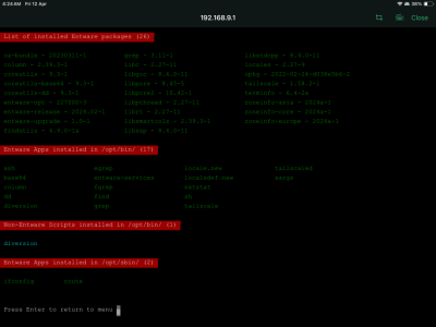

BTW, my AMTM Entware packages are showing this despite still being on the older version of Tailscale which is again a little bit at odds with what was reported earlier on here on this thread:
The tailscale package in Entware hasn't been updated since you installed it yesterday.
I'd installed a pretty old one though (and hence my earlier question about updating via CLI):
Sorry, I don't know what earlier question you're referring to. tailscale 1.58.2-1 is still the current version in the Entware repository.
