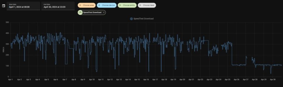

Am I the only one that this firmware caused the speed to decrease ?
Already have QOS disabled, Traffic monitor, etc.
Any ideas ?

I suggest you test another router. It's the best way to track down the source of the issue. If it turns out to be the RT-AC68U, I suggest a factory reset after saving your settings. If the issue persists, your router is likely defective.
I'm assuming you're using ethernet and not Wi-Fi for the tests. If not, test with ethernet to isolate the issue.
