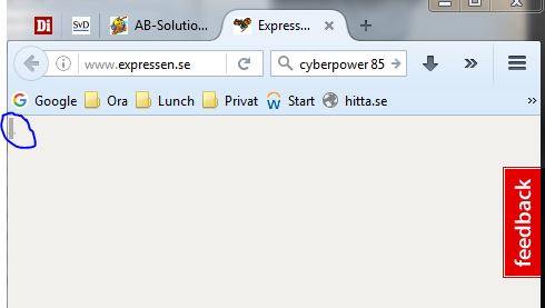

When I look a bit closer I find something very small in the top left corner - is this a anti-ad-blocker or something? Any ideas how to solve this?
The ad blocker is working fine. It's just some text above the ad.

Right i think that should be show screen with info that ad-blocker block page.
Sorry, I misunderstood, so there is nothing on the screen, it's blank? Do you have a screenshot?
The blue "circle" is a marked "item" on the gray screen - one can not see that except if one select all on the screen...
