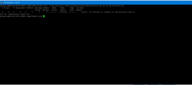

yes, I tried two different USB drives. I can see the problem with ab-solution is that it doesn't connect to the main site its trying to download and install from. The whole process times out after like 45 seconds of trying to connect.

I can only access his site when I turn on my client VPN on Windows or iphone. Without the client VPN his site just tries to load and times out. So I SSH into merlin router with and without client VPN and both time out when trying to install ab-solution.

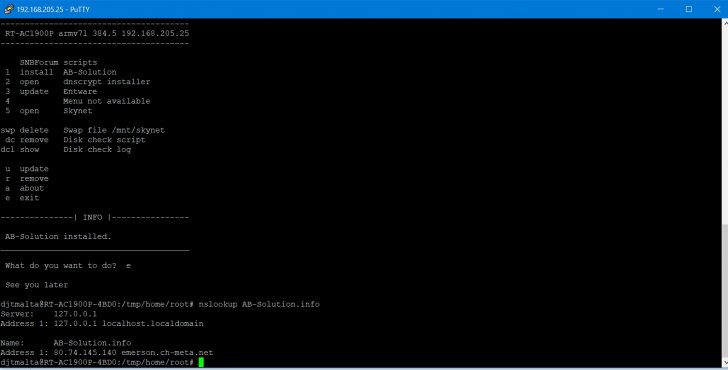

What is the output of nslookup AB-Solution.info on the router?

Output of nslookup ab-solution.info in the photo:
I just noticed it goes to a website that has .ch in it?!?! Is that correct? I have the country ban of CH (China) in my skynet country block.,
CN is China. CH is Switzerland, which is where AB-Solution is hosted.
