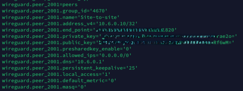

This is my configuration.
Looks like you don't have masquerading enabled for neither wan or Wireguard which may give issues if you have lan clients using wan.

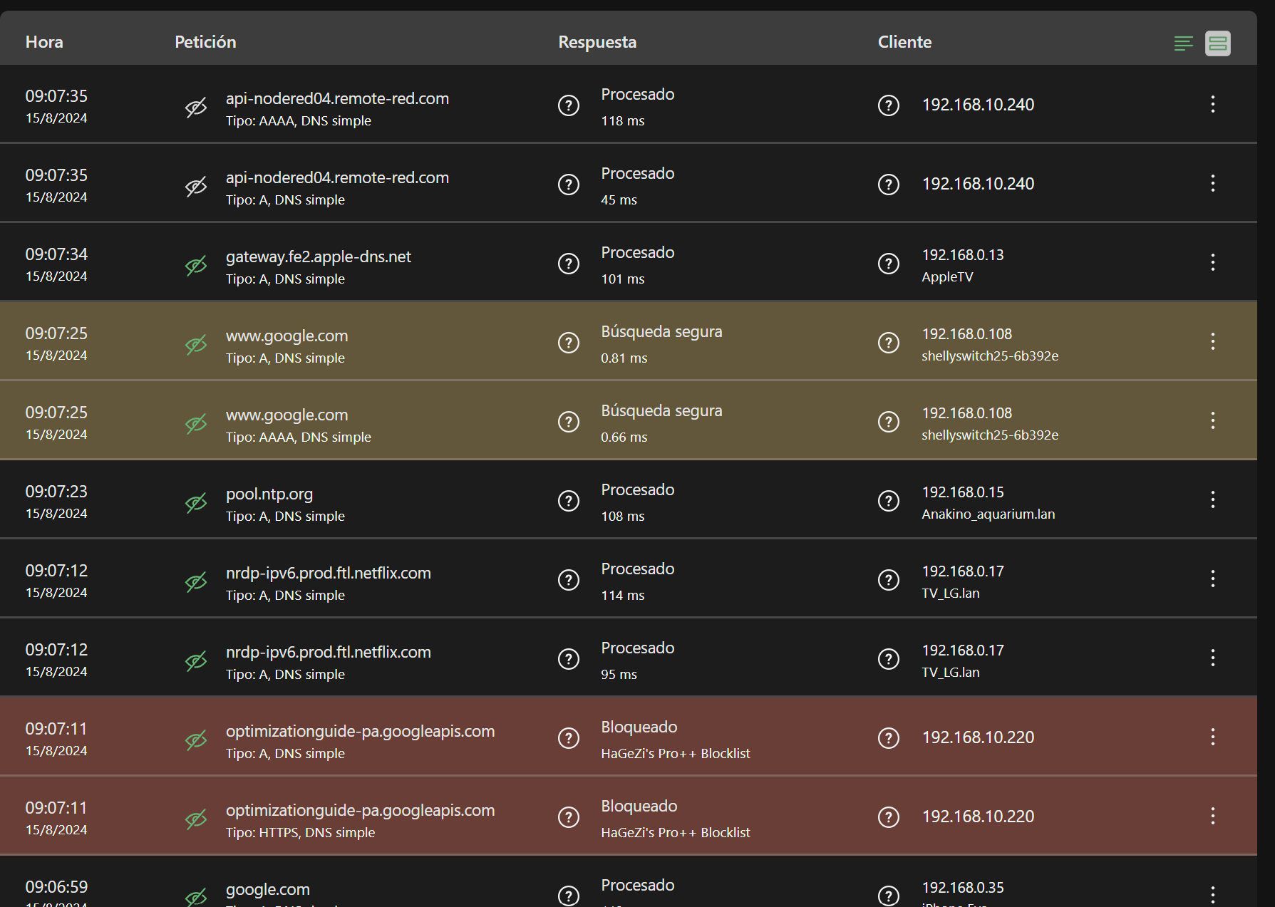

yes it works for me.
Great you managed to sort this out, and thanks for the link!
Just a couple of notes:
- According to this post: https://forum.gl-inet.com/t/vpn-wireguard-and-adguard-home/45861/16 You added a static route in the asus router. This should not be needed as you added remote lan in AllowedIPs (server) and could be removed. I don't think it does any harm though but it does not look correctly formulated.
- The redirection rule you added:
iptables -w -t nat -I PREROUTING -i br-lan -p udp --dport 53 -j DNAT --to 10.6.0.1
Only covers udp dns packets, which most dns requests are, but not all. Some are tcp. For completeness you should also add:
iptables -w -t nat -I PREROUTING -i br-lan -p tcp --dport 53 -j DNAT --to 10.6.0.1

Thanks. I add the line.
