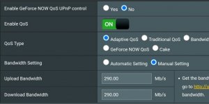

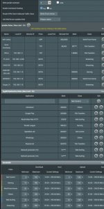

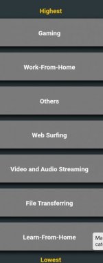

Here's how I have it config'd. If you see desktop-sfd-lan is my gaming PC, but I only forced unidentified traffic to "Gaming" for that IP
