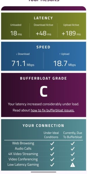

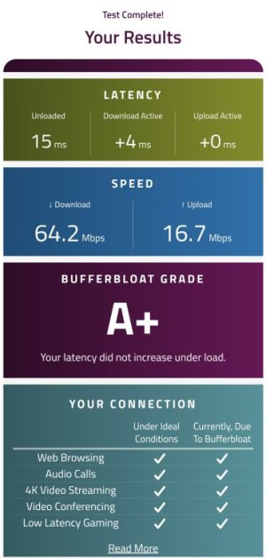

Hiya Folks ..Well after a few weeks of experimenting with CakeQos & FlexQos which one have I felt overall gives me and my network/environment the best and most important efficient running network router and client devices the winner 🏆 is CakeQos .
After my own experience and experimentation between the two Qos's and my bandwidth available it definitely works really really well to be honest.
After taking into consideration plenty of comments on this thread alone and previous threads. Also taking into consideration that Flex is no longer maintained and won't be upgraded or modified anymore ...Cake is embedded within MerlinWRT!!! So that alone states rather alot . Also Cake is not reliant on scripts running either so when you reboot your router it won't simply disappear so you don't have to worry about having to use a backup or running a separate Jffs backup for it either.
Based on my consistent EE UK FTTC 80/20 connection my cabinet is only around 6-7min away from my flat thankfully.
I get a sold 74DL and 19UL which I actually think is pretty darn good alot of folks get worse than that .I don't have any means for VM FTTP or Community Firbe for London yet to come around my particular area . Anyhow it's all about making what I have run as efficiently as optimal as physically possible and I believe I have done just that .
See the pictures below 2 Waveform tests done without any Qos enabled and then Cake after woods ..What a big significant difference it does make .

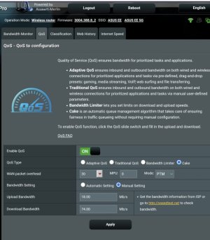

So what I setup above is 100% correct and that's it leave the router and Cake to do it's magic.👀🤔...Thanks .
I read about taking a percentage of 10% - 15% of your DL & UL speeds but that's based on comments I've seen around also I seen your comments based on hijacking the thread and I apologise if that was aimed or included myself I'm with BT which I assume is pretty much the same connection so following this thread quite closely.
With it can I ask why you're using an overhead of 30 when the default value is 22 for VDSL2 Bridged?

Anyhow...back to your comments well I have my Asus RT-AX86U Pro in full router mode bridged with my previous (2015) TP-Link Router VR2600 set as a dumb DSL modem mode aka bridge mode with DHCP and WiFi all disabled . It's an old router now but it's got a rock solid Braodcom chipset never drops a connection and I've serviced it a few times replacement heatsink compound and cleaned up inside .
So my Asus router as far as CakeQos is concerned it's set that was as it is a VDSL2 PPPOE connection and it should be PTM not ATM which is the older standard to my knowledge. Yes it's a EE connection which is essentially BT anyhow.
When I setup my Asus router it's set as a PPPOE connection which it is as that's the data/protocol coming from the DSL modem .
