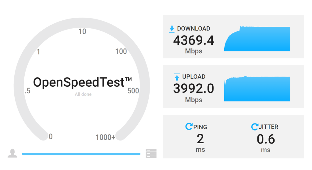

Edit3 &4: Downloaded a LAN speed test called "OpenSpeedTest-Server" from the Microsoft Store. This 1st test shows internal Win11 PC speeds. In other words, it shows the speed within the PC - not through the LAN. See results below:

Edit3: Downloaded a LAN speed test called "OpenSpeedTest-Server" from the Microsoft Store. See results below:

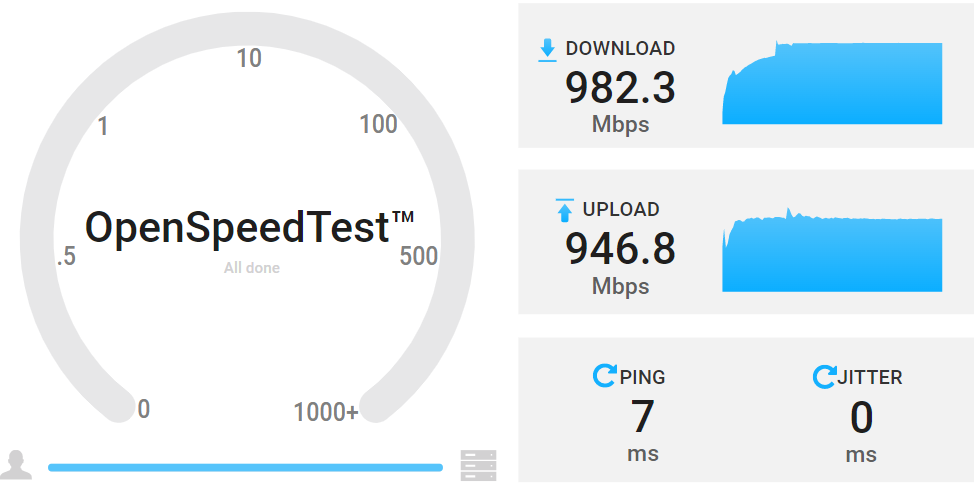

This morning, I tried running the LAN speed test again. This time I ran the test across the LAN:
  • Initiated from a different Windows 11 PC that was ethernet connected to my router
  • To my Windows 11 PC notebook on 5Ghz WiFi.
This test should provide a true speed test through my router. The slowest link in the PC LAN to PC LAN connection would be my PC WiFi. Here is the screen shot of results.

This makes sense. It is a little slower than I expected, but that is because I needed to re-position my Win11 PC. The Tx/Rx values during the test are 1921.5M 1441.2M respectively. I know these OpenSpeedTest values will increase to about 1200M when I am right on top of my router.
