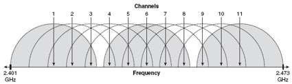

...1l means that channel 1 will be the lower channel (so, the other channel the router will use is 3). Likewise, 11u means 11 will be the upper channel, so 9 will be used as the lower channel.
Currently the secondary channels would be 5 and 7. That is what you meant, right? There hasn't been a change?
That depends on what channel you chose. With 6l, it would be 8. With 6u, it would be 4.
Nothing was changed, it's just combined in one single list now.
When I look at a 2.4 GHz band 40MHz width channel with inSSISer the secondary channel is always 4 channels away not 2 (which would then only be 30MHz wide). 1 bonds with 5, 11 bonds with 7, 6 bonds with 2 or 10. At least that is the way my ASUS has always automatically done it. It is probably different on the 5GHz band but each 2.4GHz channel number is 5MHz from the next one (thus the admonition to only use 1, 6 or 11 for our 20MHz channel. So, the secondary couldn't be less that 4 channels away without excessive overlapping.
And that makes sense because one of the rules in the spec is that you can't have 2 2.4 GHz band 40MHz access points in the same vicinity (such as 1+5 and 11+7) because they would sense each other due to the overlap and at least one if not both would revert to 20MHz.
I fortunately live in a semi-rural location so I can hog the 2.4GHz band!
Anyway sorry for drifting off-topic. I am headed off now to install and exercise the new firmware. I have missed several generation so now seems the moment to get with the times...
You're correct, sorry. Does it show that I never waste my time with 40 MHz width on the overcrowded 2.4 GHz band? :)
