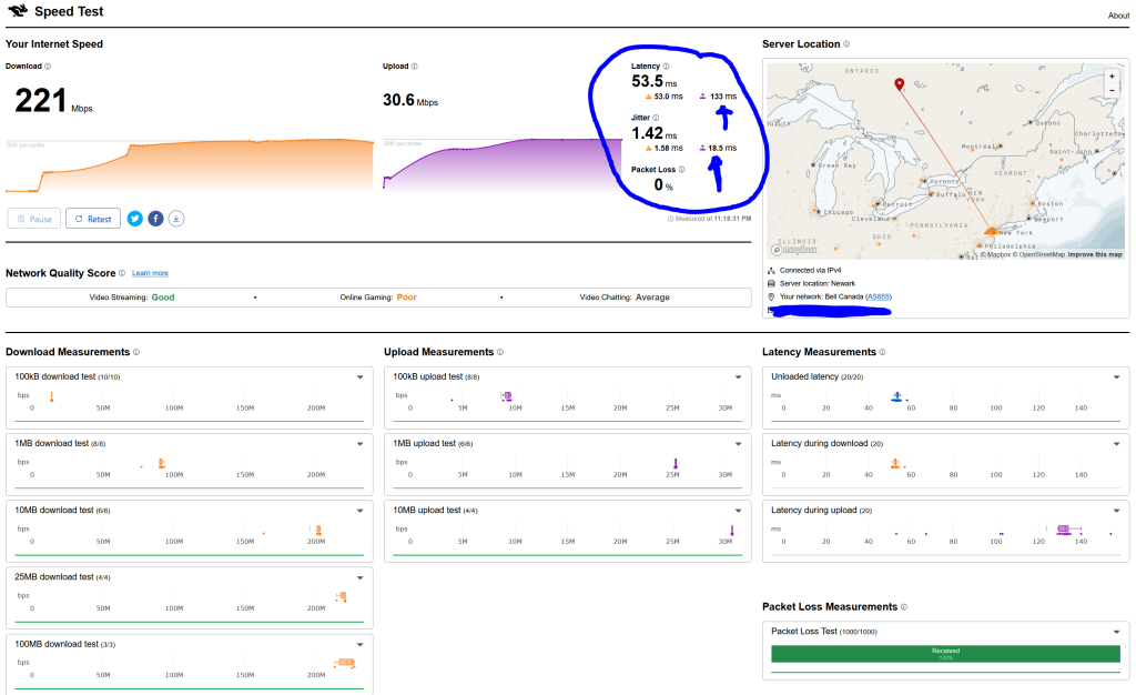

Think might be a bug for QoS, the download seems to apply and stick, the upload either doesnt appy or stick or both?

I had a similar problem when I had vdsl but it was fixed by changing the wan packet overhead values. If you don't know the provider's wan packet overhead values, try setting the bandwidth limiter to about 15% less than your normal speed.
Another thing I noticed is that The "Internet Traffic" counter in index.asp when there is traffic via a vpnclient cannot correctly divide it into upload and download and as the download speed increases, it shows (incorrectly) that the upload speed is also increasing at the same time.
This is 250/30 fibre, I did try from 1Mbps all the way through on this and last version of merlin, DL fine, it's the upload that doesn't stick or work at any setting. Thanks for tip though.
"If you don't know the provider's wan packet overhead values," I could try to find that. thanks.
