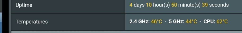

AX88U- 4 days uptime with Beta3, no issues so far.

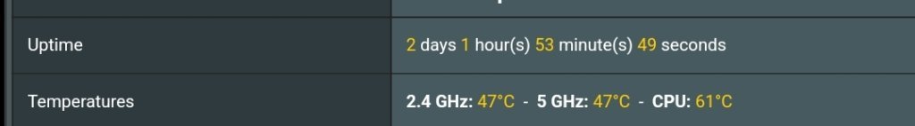

Ax56U- after an unusuall crash was 2 days ago, I manually reboot the router from the GUI for healthier proccess of tests and debug.
For now, 2 days and no issues.
Will keep monitor untill Beta4 or Stable release will be out.
