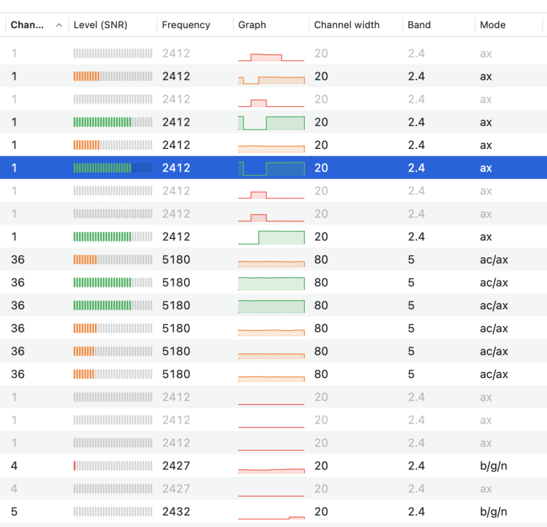

For reference, here is what Netspot shows in terms of local wireless interference (I'm sitting <10' from the BE96U):
All of the networks from top through 36 in this screenshot are 'my' networks. I must admit to previously failing to note the mode that was being defaulted to (this column is by default pushed to the far right in the UI of Netspot). My previous mesh setups had this limited to b/g/n or ac modes. I can see this being problematic for some of these IoT devices. Wouldn't really explain the issues I've been seeing on 5GHz, but at least that might be a start at places to investigate.
However, when I look into forcing b/g/n/ac only modes in the merlin fw, all I find is 'Auto' with b/g protection (which I have checked). Is there a method to control this via ssh or telnet?

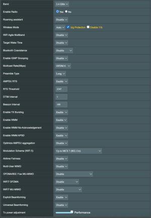

This is found what works best for my 2.4Ghz. YMMV. I only run IoT devices on my 2.4Ghz network. I did delete the default created IoT network and created a new one after factory reset. For some reason the IoT network after factory restore was wonky.
Thank you! I have applied these settings to see if things improve, and will report back on my experience. I recall now having most of these settings also applied with my previous AX89X setup and similarly in the Orbi (as 1:1 as possible given the differences). Unfortunately, I was unable to import the AX89X settings into this new setup due to an import issue. I assume that was likely just due to the AX89X not supporting Merlin however and trying to import a settings config from stock to Merlin. And like you, I mostly only run IoT devices on the 2.4GHz network, though I do have 2 cameras and one old laptop that is still limited to that band, so it's not 100% IoT.
Only been an hour or so now, but I can already tell that the latency with interaction between 5GHz and the 2.4GHZ IoT networks is drastically reduced. I have some WiFi power strips and it was previously taking many seconds for commands to be received. With these changes, responsiveness is nearly instantaneous, just as it was with my prior network setup. These IoT suggestions should really be in a sticky for this sub.
