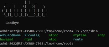

Will try also the manual install later, here is the screenshot of your command:

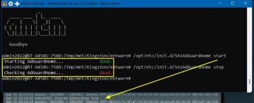

Maybe for info, from your "hand" install manual, I found it courious that for the first time I've seen "done" instead of "dead"... (attached picture) - not that it gives any meaningful result in log or that I could run gui, but still, wasn't "dead"... :) but I am not sure... I was running "S61AdGuardHome start", and usually it was S99 not S61...
