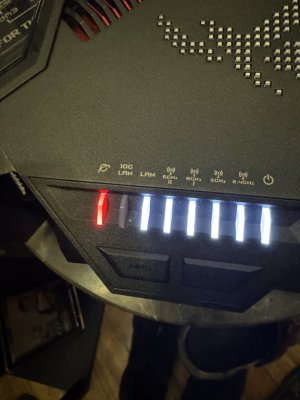

Whenever I do a hard reboot on this router, the internet doesn’t immediately re-connect. I get a red light (no internet detected) on the BE98’s LED panel (pictured).
I have to hard reboot the router 2-3x before the red light finally goes away and internet is restored.
Is this a normal/jbown bug with this router or is this abnormal?
Other than that this router is really performing really well. Thanks

How long are you waiting between hard reboots ?. Sounds like it is just waiting to receive an IP assignment from your ISP or maybe a bad cable between your router and Modem/ONT. You could try playing with the "DHCP query frequency" setting under WAN Advanced Settings page. Just curious..what issue are you seeing which requires a hard reboot to resolve ?.
Thanks for your reply. I usually give it 3-4 minutes after rebooting it. Sometimes it connects within a min. Sometimes the red light stays on for a few minutes or doesn’t go away.
No. I just like to hard reboot the router at least once a week. I have already changed that setting from aggressive to normal mode with no luck.
I’m currently connected to the 10 GB LAN port from the modem so I might switch to the 2.5 GB port to see if that makes a difference. Other than that, the router has been outstanding with no other issues.
Sometimes, it's the ISP not realizing that you had disconnected, and not allowing you to reconnect that soon because it thinks you are attempting to establish a second connection in parallel. Give it 4-5 minutes and see if it eventually connects.
Thank you! I will try that the next time I do a hard reboot.

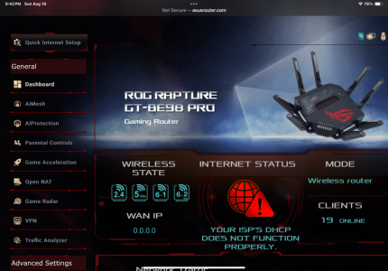

When AUTO WAN DETECTION is enabled - the red internet connection light does not go away, regardless of how long I wait. I have to change the WAN detection setting to 10GB only for the connection to the modem to be established. So damn frustrating.
When set to Auto WAN detection, this is what I see on the ASUS dashboard UI….”YOUR ISP'S DHCP DOES NOT FUNCTION PROPERLY.”
Will only a firmware update fix this issue or is it something else?
