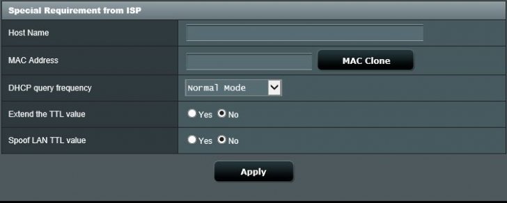

3831 added TTL values(enable/disable) in the WAN section. I'm not sure what's the purpose??
There's one Asian ISP that applies a TTL of 1 to their inbound traffic, which means that the traffic will only work on the first device right behind the modem, preventing the use of a router (which would add a second hop).
They added something close to that over a year ago, but it was half broken, so I kept it disabled.
