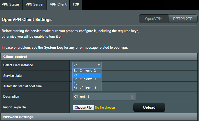

Other problems: Certain clients will connect but not others. Client one for example refuses to work. Also I am unable to start multiple openvpn clients at once; the provider supports multiple connections. All settings except IP are the same as the one that is connected and functional, however I get this error with client three, (this is while client 2 is connected):

Strange phenomenon, client 2 got renamed to client 3, and other clients were renamed; some had no name, here is a screenshot

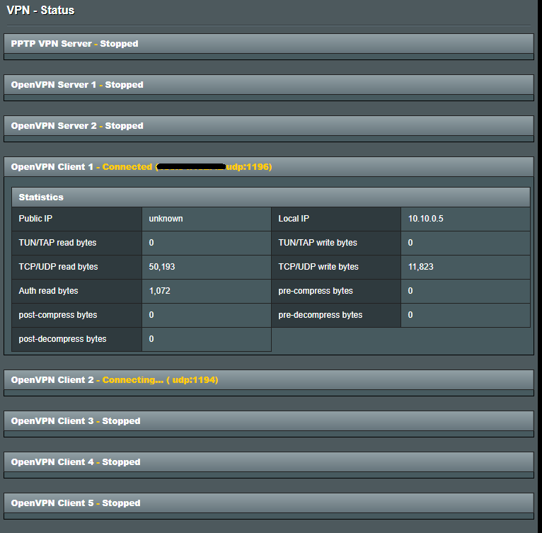

Issues connecting to multiple vpns at one time, although IP is set you can see it shows the client is connecting to nothing;
Mar 19 10:27:23 syslog: VPN_LOG_ERROR: 487: Starting OpenVPN failed...
Mar 19 10:27:57 ovpn-client2[13325]: Options error: No client-side authentication method is specified. You must use either --cert/--key, --pkcs12, or --auth-user-pass
Mar 19 10:27:57 ovpn-client2[13325]: Use --help for more information.
Mar 19 10:27:57 syslog: VPN_LOG_ERROR: 487: Starting OpenVPN failed...
This happens on client 2 no matter whether client one is connected or not; looks exactly like what was happening earlier; in other words, some of the other clients should work just fine.
