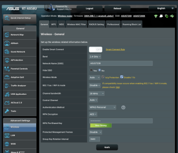

I'm new here so I'll apologise in advance; I've got the ASUS RT-AX58U V2 which doesn't seem to follow the settings regarding channel and Width
Seems to default to Auto channel and then 40Mhz on width I'm not sure if I need logs are anything so I'll take the flak as a welcoming gift 👋😬

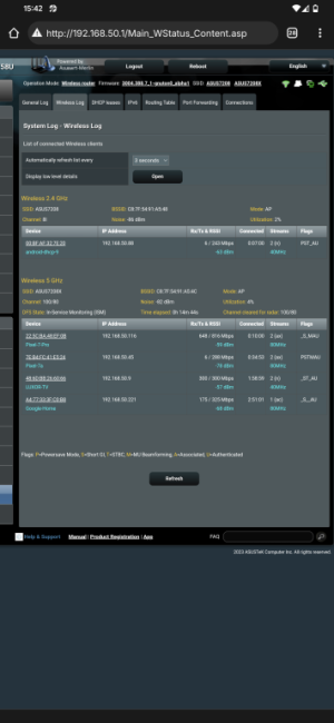

Post screen shots of what you're looking at. e.g. Wireless - General and System Log - Wireless Log.
Sorry, I've typed this on my device thought I mentioned that and now you say it I believe the 5Ghz is also not playing along either...

Settings don't seem to stick in the WebUI either which I should mention I choose and channel and save it seems to refresh but nothing changes :)
  • syslog.txt
Your first screenshot is too small to read.
This is likely the problem. Have you tried doing a factory reset and configuring it again? Otherwise it could simply be a bug. In which case try using an earlier non-alpha firmware.
