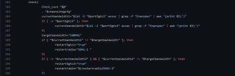

Just a guess but it should be as easy as putting lines 190-191 in its own if statement (assuming nvram get model returns XT8 as a model name)
targetbandwidth="160MHz"
if [ "$currentbandwidth1" != "$targetbandwidth" ]; then
    if [ "$(nvram get model)" != "XT8" ]; then
        restart5ghz1="true"
        restartradio="5GHz-1 "
    fi
fi
        restart5ghz1="true"
    fi
fi
something like
nvram get productid
may work.
e.g.
RT-AX88U-C7C0:/tmp/home/root# nvram get productid
RT-AX88U

I’ll update the logic this week to support this model. Hard for me to find edge cases like this sometimes with so many models in the wild and limited testing devices.
