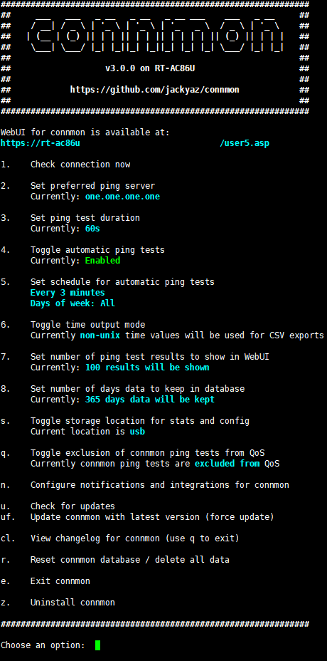

Command Line
To launch the connmon menu after installation, use:
connmon
If this does not work, you will need to use the full path:
/jffs/scripts/connmon

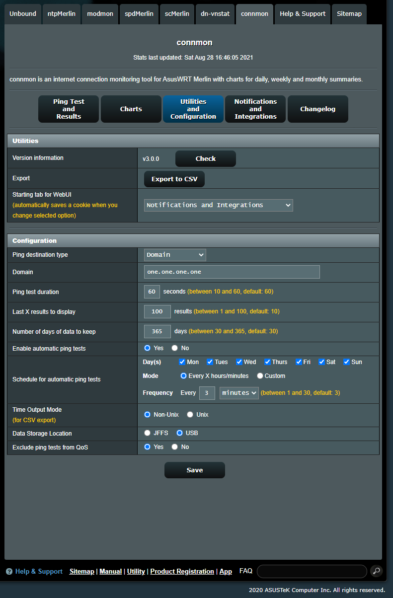

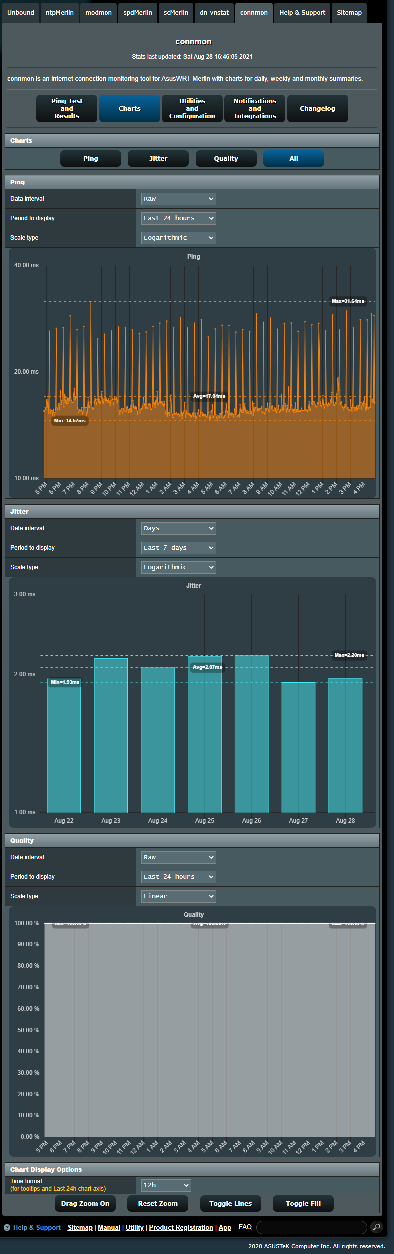

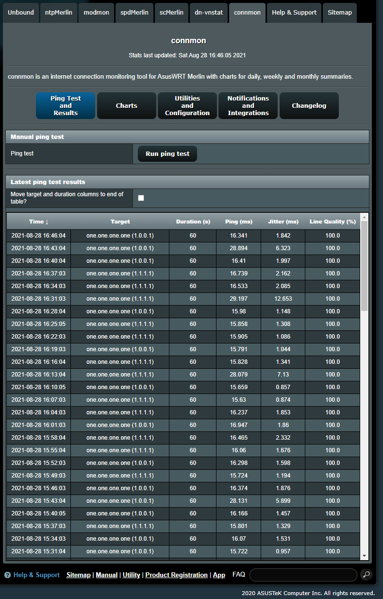

Screenshots
v3.0.0 is now available
  • NEW: Notifications and integrations
  • NEW: Changelog displayed when updating
  • NEW: New-look WebUI page

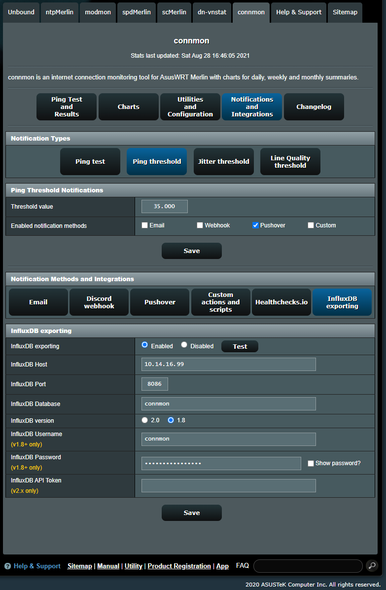

Notifications and Integrations
Currently, supported mechanisms for notifications/integrations are:
There are 4 events which trigger the notifications:
  • On each ping test
  • Ping threshold exceeded
  • Jitter threshold exceeded
  • Line Quality threshold exceeded
