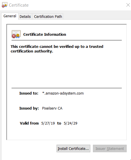

Perhaps you put it in the wrong cert store.
  1. Click "Install Certificate.." and select "Local Machine".
  2. Click "Place all certificate in the following store" on next screen.
  3. Click "Browse..." and select "Trusted Root Certification Authorities".
  4. Click "Next" and then "Finish" on next screen.
Restart browser to take effect.
Firefox by default doesn't trust certificates installed via Windows certificate trust store, you need to either import the certificate directly in Firefox or enable Windows certificate support.
You can enable this feature in about:config by this boolean value:
security.enterprise_roots.enabled
and set it to true.
Yep..maybe wrong place :rolleyes:. When I go to install again, get advised the certificate is already installed, but doesn't advise where.
I manually looked through all the certificates under "Certificates - Local Computer" and didn't see any with text of "pixelserv". Did the same with Windows regedit and no hits. What should I be looking for to remove, to allow re-install?
Are you getting certificate errors on Egde as well or it's just Firefox?
It should be under Trusted Root Certificates named Pixelserv CA, IIRC.
Or named with the pixelserv-tls IP address, something like 192.168.1.2:443
Looks like a Firefox pop up. Look for the certificate named after your pixelserv-tls IP, it'll be registered as something like this: 192.168.1.2:443
In Firefox, the certs are viewable in Options / Privacy and Security. At the bottom of that page are the Certificates. It should be listed under Servers.
