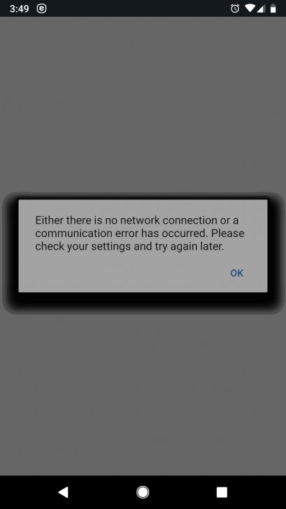

Is anyone else having issues with the android app Fandango? I keep getting the message in the attached screenshot when trying to select a time for buying movie tickets. I've tried whitelisting blocked domains with the [f] (follow dnsmasq.log) option to no avail. The app works if I disable ad blocking.
Try leaving blocking enabled, but disable pixelserv. See if you still get the issue. There are some site that don’t like pixelserv.
