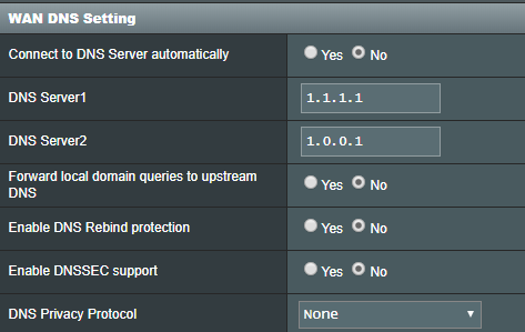

Been using Diversion for months and lately I've noticed that it doesn't seem to be blocking ads any more. I've updated everything Diversion related, the router firmware, and restarted but still nothing. Was there a change that I missed that my WAN DNS setting are interfering?
Check if you have the setting "Wan: Use local caching DNS server as system resolver (default: No)" in Tools / Other Settings in the router UI.
If so, set it to "Yes".

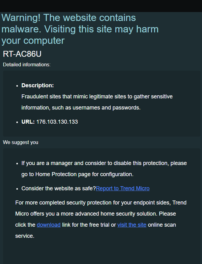

@thelonelycoder, thank you for your work! I use it the last year and it is amazing! But what about an opportunity to add the external address to the blocklist? For example, I would like to use this address as the page of blocking:
http://176.103.130.133
What's your reasoning for such a request?
This would be very slow, making your web browsing an unpleasant experience. Apart from that, this address does not answer to ping from where I am.

Yeah, its AdGuard blocking page address from their DNS:
https://adguard.com/en/adguard-dns/overview.html
I just uses it like example. I meant to use the external IP address for own page of blocking with the description.
