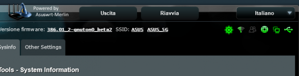

At the moment, the beta 2 of gnuton has been running for 3 and a half days without any reboots and without any problems. Tonight entering the control page, I notice a kind of blue distortion in the background, I think it's just a graphic matter. It wasn't there before, probably it disappears with a reboot, but since that's fine, I won't reboot
