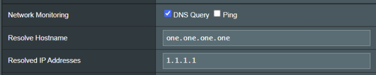

That's a known problem that's unrelated to the VPN. Have you changed the Network Monitoring settings (Administration - System), or blocked Microsoft telemetry?
Network Monitoring:
Looks like the default settings to me.
Blocked Microsoft telemetry:
Not that I know of. At least not in/on my router.
I don't care much if this known problem is just a UI thing without any consequences.
If it's what I think it is then it's just a UI thing. In which case setting Network Monitoring as follows should "fix" it.
