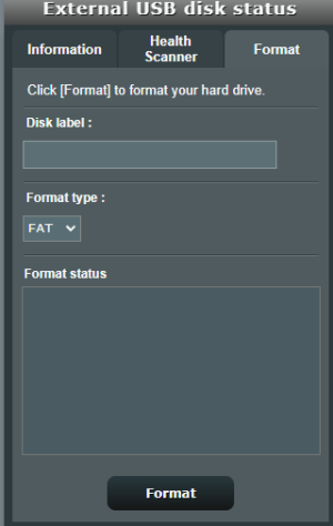

Here are the current preferences

Well it appears that chart tells the story. 4TB seems to be a common limitation. Also, I expect most external enclosures are using either exFAT or NTFS, when the better option for Linux is usually ext2/3/4.
As I often say, I don't consider the router an appropriate location for a NAS anyway. It's best left for small, transient files, typically w/ expendable USB flash drives. Placing your hopes on the router w/ that much data is asking for trouble imo.
