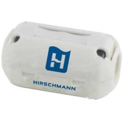

i recently changed the cabling because i suspected 4G interference.(4G and cable both use 800Mhz)
you should use Hischmann Koka 9TS cable which is triple shielded
also Hirsmann has a 4G/LTE suppressor.
may putting some of these in at the beginning and and of you cable will help
Cable is 800Mhz, wifi is 2.4/5Ghz so i doubt wifi is the issue. i would look at the 4G settings in your router
you might also want to check all the switching powersupplies(the one from your router) which are known to create interference.
