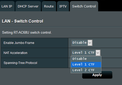

Hi Guys,
I've been searching like crazy on SNB for this and I know this has been discussed but can't find anything. What exactly is the difference in John's Fork between Level 1 CTF and Level 2 CTF? Trying to improve Fiber Speeds. Thanks very much.
