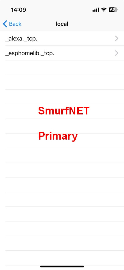

ASUSWRT-Merlin RT-AX88U_PRO 3006.102.4_beta2 Sat Apr 19 16:20:12 UTC 2025
xxxxxx@RT-AX88U-Pro:/tmp/home/root# avahi-browse -at
-sh: avahi-browse: not found
xxxxxx@RT-AX88U-Pro:/tmp/home/root# avahi-browse-domains -at
-sh: avahi-browse-domains: not found
I guess I would need to install the avahi-utils entware package for this?
I'm a wee bit nervous if I install that it will stuff up the existing avahi package of it is not needed.
