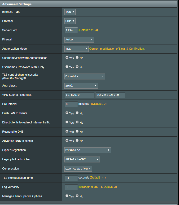

Give it a try. You won't mess up your LAN if you make a config mistake on the OpenVPN Server. Yorgi's posts at the beginning of the thread should be all you need. I think I have a screen shot of my config buried in one of the posts as well. If you have an issue, just post here and someone will lend you a hand. I usually check the posts once per day myself.Thanks for the detailed response. I'm interested in setting one up but seems complicated . I've read the thread about setting one up on an ASUS router but I'm not skilled enough I think. I'm afraid to make a mistake and mess my network up...lol
make sure that you enable the following as wellAsus RT-AC68U merlin.
Respond to DNS
Advertise DNS to clients
Also why is your server 192.168.10.0?
leave it at 10.8.0.0 and subnet 255.255.255.0

When you configure a VPN server you should leave the subnet at 10.8.0.0 not 192.168.98.0 look at the images from my guide and do it the same. done. subnet set back to 10.8.0.0

The fact that you changed the subent back to 10.8.0.0 I would default the Server then reboot the router and enter the data again and export a new .opvnConnecting the client to the VPN server hasn't been an issue. I've been using OpenVPN and your op After all the above, I am still unable to map to the server's shares.
I forgot to mention.Connecting the client to the VPN server hasn't been an issue. I've been using OpenVPN and your op After all the above, I am still unable to map to the server's shares.

I had the exact issues you where having when I updated firmware prior to .67 which I recommend you put because it works without issues for me.
I couldnt reach the shares even when I disabled the firewall from the windows pc.
what solved it was doing a default on the OpenVPN server and rebooting the router.
After that I entered the data again on the Server and exported a new .opvn and everything worked like a charm.
so you are not the only one having these issues.
It will be fixed because I know from myself that it works.
